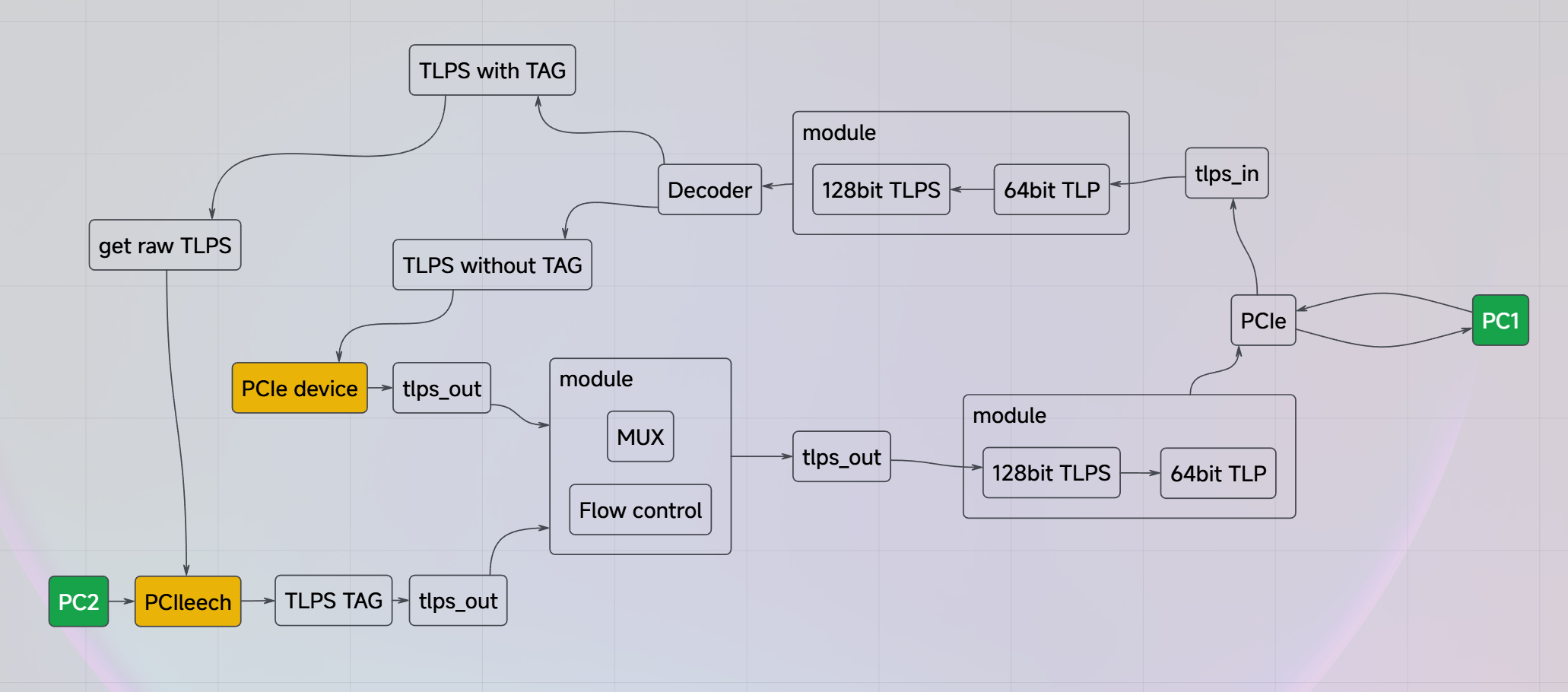

- The fw that hptt used in early days had massive problems in some of its modules - for example on some devices msi-x cap was shown as legacy msi-x, while ofcause the real device did not using legacy (only 1 example, there were a few more cfgspace related errors/bugs). But yeah atm it seems like they fixed the most of it
- here is how it works with its modules:
